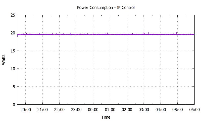

I tried with IP Control tonight:
The TV did not go into deep sleep anymore. So better don't use or recommend this setting anymore...

WHAT?!?! 19-20W constant with IP Control on?!?! Are they mad or what? It's just an HTTP/TCP service! Sure the Ethernet interface doesn't go down anymore! And sorry for the many exclamation marks, but things like this drive me mad!!
I can't believe this (well, that's a figure of speech. I actually had a strong feeling that was the case). Turning it off now, I hate to throw energy in the toilet. Not to mention that my AVR has IP Control enabled as well and the apps I tested recognize the AVR, but obviously not the Bravia. Oh, the best app I've fpund (at least for the AVR) is Peel Remote if anyone is interested to try it. Maybe it works with Android 6.0.1.
