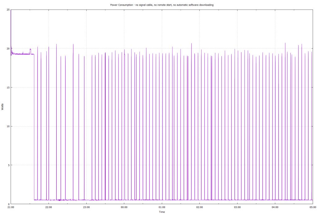

I started to measure power consumption in standby with an EdiMax SP-2101W and FHEM software.
First test I have done is with optimized settings like:
Remote start: disabled
Automatic software downloading: disabled
There are easily 50-100 wake-ups per night which might sooner or later upset the PSU.
At least with those optimized settings, it went to deep sleep for the first time about half an hour after switching off the set (going from ~20W to 0.5W).
This test was done with the antenna cable unplugged. It might very well be that the TV therefore fails to update the EPG/services, retrying every X minutes.
@Anonymous @Peter_S. Maybe you guys can find something out about Sony standby behavior? That does not look too healthy...
Next night I will try with antenna cable plugged in.

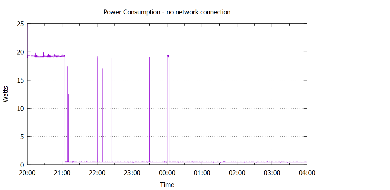

@LingUaan on German forums says that this does not happen anymore if you unplug the LAN cable and disable WLAN. Seems like the TV frequently calls home. No surprise that there are nightly crashes...
@Kuschelmonschter Ok, now I am confused. When I clicked to the link to this thread it took me to the Austrian (.at) forum.
Anyway, after a factory reset now my Ethernet interface has to reconnect at every wake up. But if I ping the TV interface from my computer, with the TV off for a whole night, it works. So I am not sure if it is (deep) sleeping or what either.

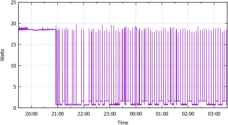

(1) WiFi disabled
(2) Remote start enabled, automatic software updating enabled (to check whether the TV goes into deep sleep at all)
With disabled WiFi, it looks indeed way better.

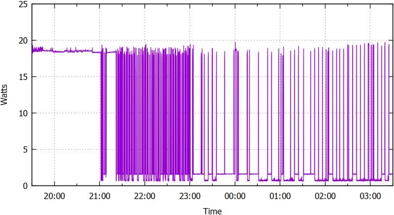

It gets even worse. This is what it looks like after enabling Remote start:
Right until 23:00, the TV kept going to sleep and waking up every few seconds without the user noticing anything. So what happens at 23:00... well... my Synology NAS is being switched off for the night. Some network traffic indeed prevents the TV from staying asleep. I wonder how long the TV can survive that and how many broken power supplies suffered from this issue...

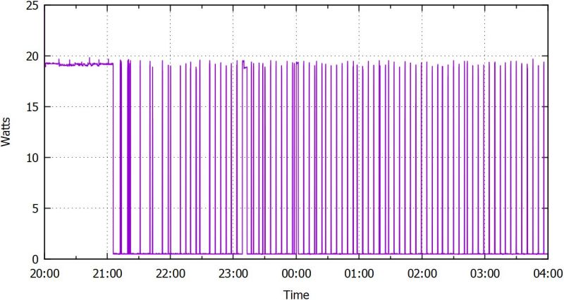

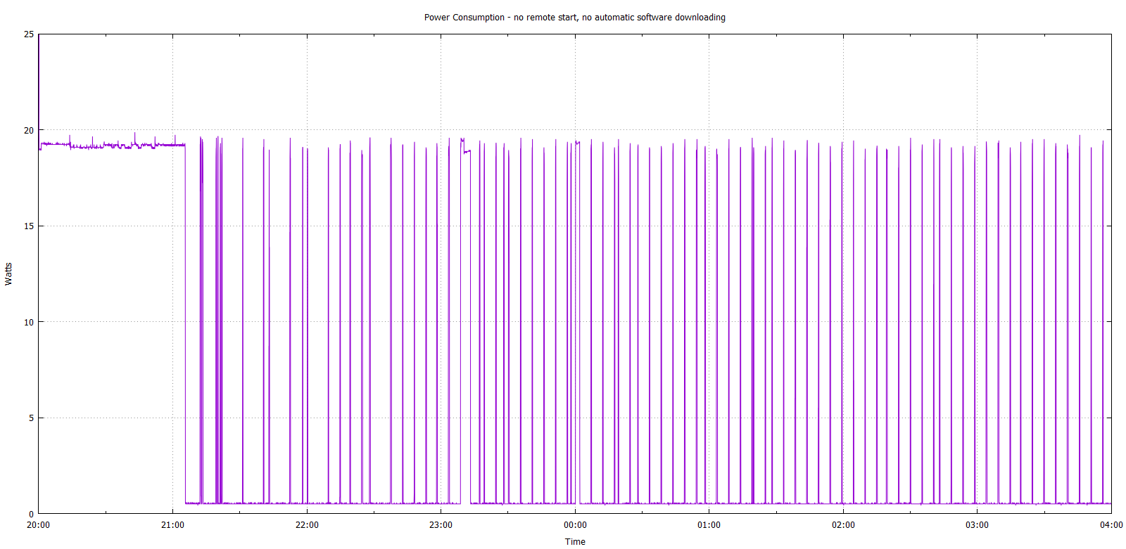

But even with Remote start being disabled, the TV keeps waking up every few minutes in my network, also with the Synology NAS being switched off. So there still seems some traffic that wakes the TV up which stops after unplugging the LAN cable and switching off Wi-Fi.
It would probably be best if the firmware shut down the network interfaces when going into deep sleep.
Kuschelmonschter schrieb:Right until 23:00, the TV kept going to sleep and waking up every few seconds without the user noticing anything. So what happens at 23:00... well... my Synology NAS is being switched off for the night. Some network traffic indeed prevents the TV from staying asleep. I wonder how long the TV can survive that and how many broken power supplies suffered from this issue...
It was the ZeroConf protocols (Bonjour/SSDP) on my NAS which caused this huge mess. The problem is not solved though. In the IoT era you might have some devices in your home which announce their services over ZeroConf. And even after disabling the services on my NAS, the TV still woke up every few minutes, even with Remote start being disabled, which is totally not acceptable!!!
Remote start on (Bonjour/SSDP enabled on NAS until 23:00):
Remote start on (Bonjour/SSDP disabled on NAS):
Remote start off:
@Kuschelmonschter Just out of curiosity, what's the average power consumption per hour in the best and worst cases? Because Sony claims it is 0.5W w/o network and 3.00W(Wi-Fi) / 3.00W(LAN) / 0.50W(Bluetooth), so I assume 6.5W.
I believe the manufacturers are bound by law to respect some values, as I think the real values can't be (much) above what they claim. I'd like to know what some crazy environmentalist think about this.. (anything in order to have Sony/Mediatek fixing that awfully broken OS).
