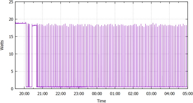

I started to measure power consumption in standby with an EdiMax SP-2101W and FHEM software.
First test I have done is with optimized settings like:
Remote start: disabled
Automatic software downloading: disabled
There are easily 50-100 wake-ups per night which might sooner or later upset the PSU.
At least with those optimized settings, it went to deep sleep for the first time about half an hour after switching off the set (going from ~20W to 0.5W).
This test was done with the antenna cable unplugged. It might very well be that the TV therefore fails to update the EPG/services, retrying every X minutes.
@Anonymous @Peter_S. Maybe you guys can find something out about Sony standby behavior? That does not look too healthy...
Next night I will try with antenna cable plugged in.

I measure 3-4 minutes per hour in which the TV consumes 20W due to wake-ups. The rest of the time it is at 0.5W. These numbers are without Remote start being enabled. In that case I would expect the TV to permanently stay in deep sleep (0.5W) without any wakeups, which is not the case though. So the average will be higher than those 0.5W of course.
After enabling Remote start, deep sleep power consumption increases to 0.5-2W (I think this is the 3W figure provided by Sony), from which it also frequently wakes up like in the above case. So the real average might be higher.
The problem is that the average depends on your network environment and how often it makes the TV wake up. The TV seems quite sensitive to certain traffic and consequently will wake up more or less often. So probably with a router and only the TV connected to it, it will stay asleep, constantly only drawing those 0.5W.

Your network behavior indeed looks quite weird. However turning down the network interfaces in deep sleep does not sound wrong as it most probably fixes the frequent wake-ups. I have to manually disable WiFi to make the wake-ups go away. NICs should of course be re-enabled on resume.
I now did some more testing. I performed a "forced factory reset" together with a "data factory reset" to be abolutely sure, see here. I only set up WiFi and the Google account. The processor still wakes up every few minutes. I then tried a different Access Point with only the TV connected. Still same problem.
So this is for sure a FW problem, at least with Marshmallow. I am also quite confident that those wake-ups sooner or later cause those crashes/reboots that we also observed.

profile.country.AT.title
Kuschelmonschter
Hero
I gave up contacting Sony support for this reason.
If they ever answer your mail, they will ask you to perform a factory reset. I am quite sure about that. It won't help like most of the time. I tried...
profile.country.HU.title
fezo01
Explorer
they do not read this forum?
I also feel that they do not deal with the problems of users!
I did the factory reset.
I did not accept any privacy (sony and google).
Unfortunately, the TV also turns on every 5 minutes and connects to the Internet.
Jecht_Sin
Enthusiast
No clue what IP Control does...
The problem is that before the reset I had WiFi disabled and the Ethernet was connecting immediately after wakeing up. Now it takes a minute.
Now I enabled IP Control and the connection is always there. The downside is that I believe it doesn't deep sleep anymore at all. It's too fast to wake up. And I agree, I am quite sure we can add the Deep Sleep/Wake Up issues to the list of major bugs in this OS. Which includes: Audio PassThrough, USB Module, and I'd put Profile VP9.2 Codec on Android 7.0 as well (maybe it isn't major but sure it is annoying).
Kuschelmonschter
Hero
Did you try static IP?
Resume from deep sleep is generally pretty fast. The fact that your TV probably does not deep sleep anymore might also be the reason why you are not seeing so many silent reboots anymore. I am pretty confident that the two issues are connected...
Kuschelmonschter
Hero
I found something about IP Control here. So you can control the TV by sending it commands over network. I think your assumption that this prevents deep sleep makes sense.
I never used IP Control so this is not the cause for the frequent wake-ups.
fezo01
Explorer
I have nothing enabled.
wifi, bluetooth.
if no internet cable is connected and wifi is not enabled, the TV will turn on every 5 minutes
