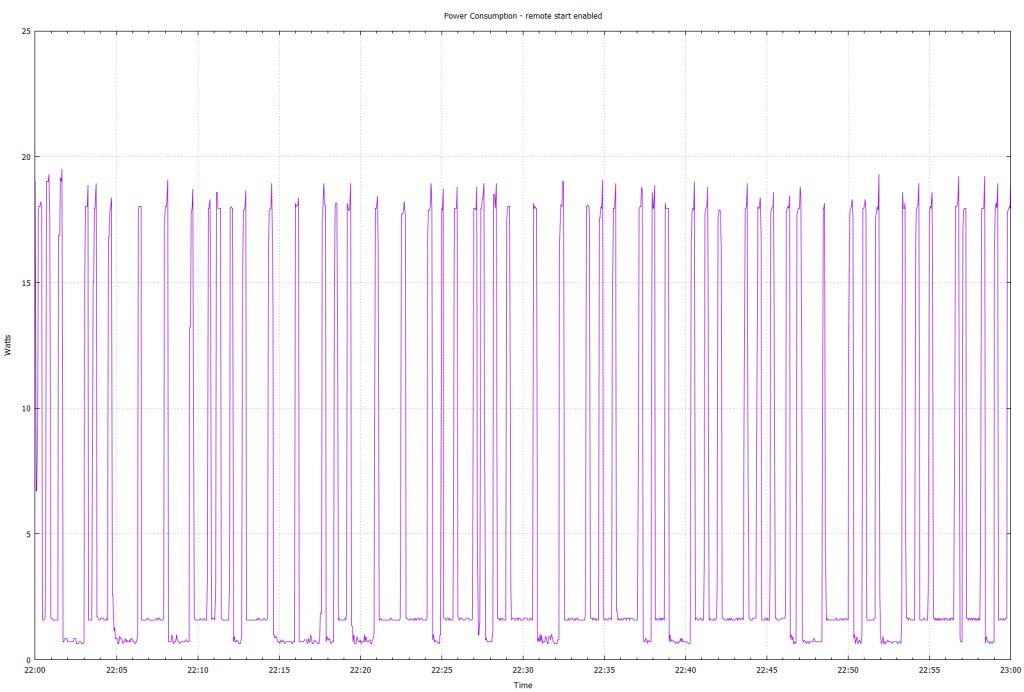

I started to measure power consumption in standby with an EdiMax SP-2101W and FHEM software.
First test I have done is with optimized settings like:
Remote start: disabled
Automatic software downloading: disabled
There are easily 50-100 wake-ups per night which might sooner or later upset the PSU.
At least with those optimized settings, it went to deep sleep for the first time about half an hour after switching off the set (going from ~20W to 0.5W).
This test was done with the antenna cable unplugged. It might very well be that the TV therefore fails to update the EPG/services, retrying every X minutes.
@Anonymous @Peter_S. Maybe you guys can find something out about Sony standby behavior? That does not look too healthy...
Next night I will try with antenna cable plugged in.

Another thing: have you tried reducing the scale in your charts (to like one hour) for your tests with Remote Start enabled? As it is it's too dense, it's hard to determine which is the time interval the TV wakes up.
Sure. I have all the raw data, so I can scale it however I want. Here is 1 hour with a tic every 5 minutes:

So it's about 3-6 times every 5 minutes. Once every 1 or 2 minutes. Even if it lasts 10 seconds (but I believe less, you should reduce the scale even more, to 5 minutes ) it should consume no more than an extra 3W per hour (16,67% of 19W). If that's so it seems to me in the norm after all. Although I don't understand at all why with the NAS off the sleeping time interval gets larger.
