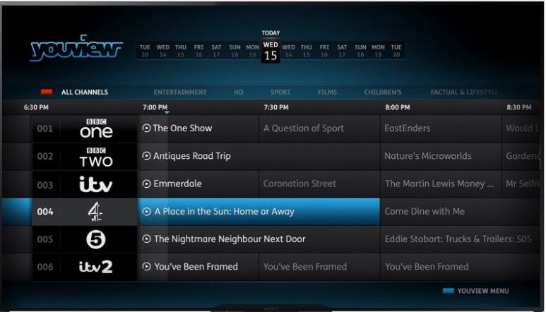

Mooly01
YouView if you have it will look something like this when you press 'Guide'.

Yes, it does have YouView as shown in your post.
