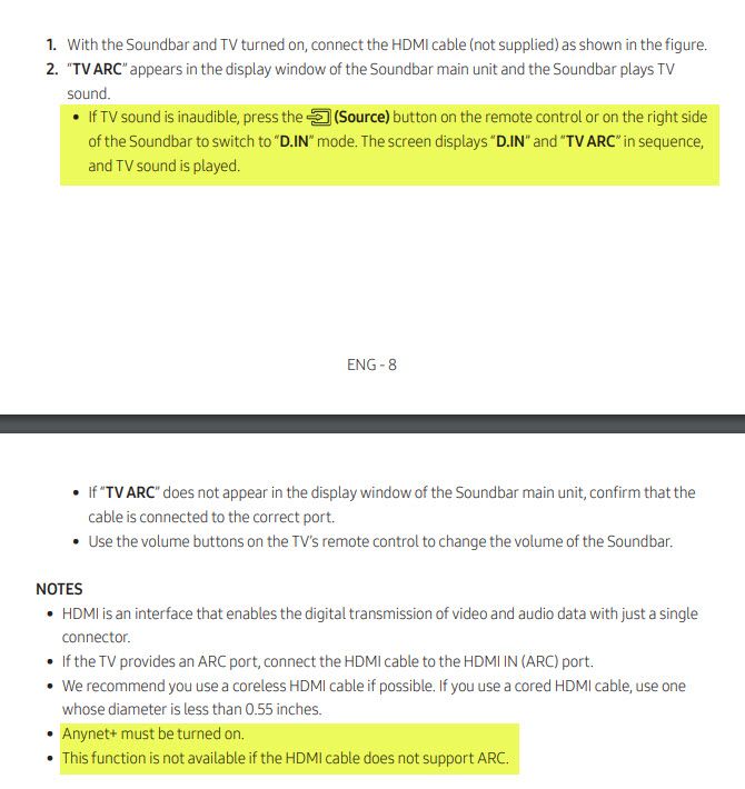

just a quick update which might help anyone else who has a problem to get sound from a Samsung soundbar when connecting it to thier Bravia's.
Samsung for some strange reason refer to CEC as Anynet+ on their soundbars so yo have to turn anynet plus on on thier bars and then turn on the Bravia sync on the Bravia tv and that's it it now turns on or off with my tv and I can control the volume of the bar using the tv remote

Whatever strange reason Samsung have for calling CEC Anynet+, it’s the same strange reason that Sony have for calling it Bravia Sync. And every other manufacturer giving it a proprietary name also.
Thank goodness ARC isn’t called Bravia Audio Return by Sony, Anynet+ Reverse Sound Experience by Samsung, and so on.
But then ARC is standard; and though CEC ought to be, it’s rather loosely defined, and most manufacturers just implement a subset, and make judgements as to what some of the behaviours ought to be, and so cover themselves with a local name for their specific implementation.
Which is not guaranteed to work with anybody else’s, though it usually mostly does.
And yes, you need the devices at both ends of the HDMI cable with ARC on it to have CEC turned on, since ARC is negotiated over CEC, rather than in the normal HDMI negotiation, being an inexplicable afterthought in the HDMI standard that anyone who had ever plugged in a SCART connection could have told them was needed from day 1. But then the USA never had SCART 😞
However, there is no such thing as an HDMI cable that does not support ARC; despite HDMI cables predating ARC, ARC just uses a pair of pins that were always wired together, in even the earliest HDMI standard, despite how this wire was to be used being undefined, and left for future expansion.
