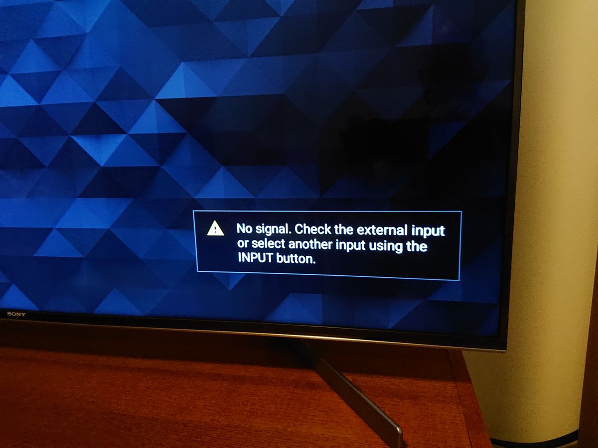

techn001
@royabrown2
Thank you for the reply. As I said though, that diamond pattern is the screen that indicates no signal on my TV (i.e. an empty HDMI port or a powered down device connected to it). The only difference is that the usual message telling you that there is no signal is not displayed during the bug described in the OP.
Diamond pattern usually indicates no signal on this TVDiamond pattern usually indicates no signal on this TV
