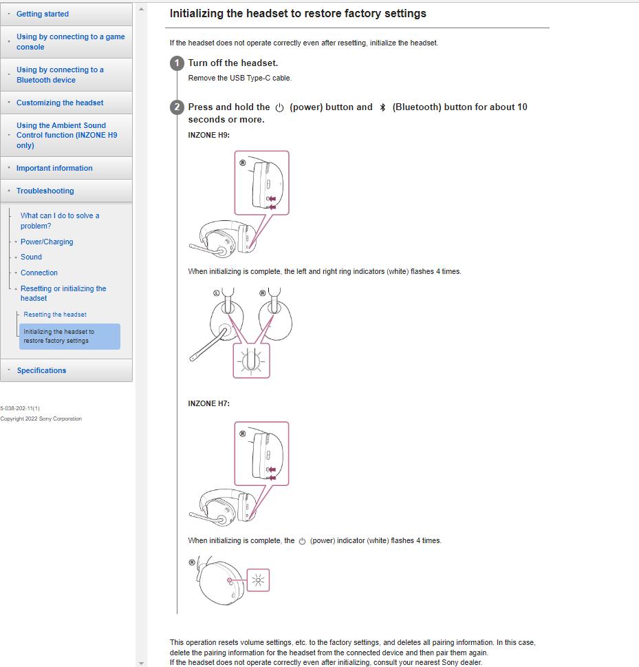

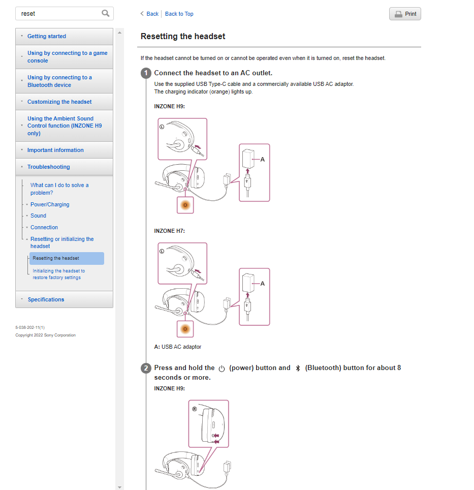

Yes you can either perform a basic reset or reset to factory settings.
Have a look at these two pages from the help guide:
Hope this sorts it out for you

Many thanks, sorry took so long to reply but had continued errors and being blocked when ever i select UK as country, i think it might have something to do with cookies on my browser causing conflict, resetting my headset with power connected has worked so many thanks again
