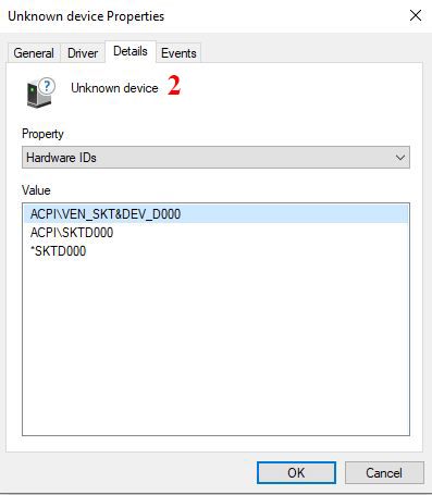

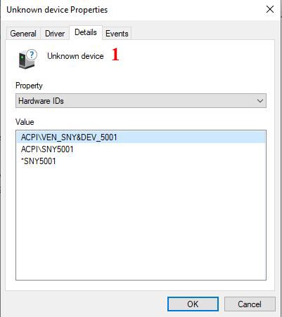

The screen shots below show the two 'Unknown' devices seen in Windows Device Manager I have marked them '1' and '2'. I have also included screen shots of the Hardware ID's of both items also similarly marked for identification. I have searched for and installed drivers for both unknown devices but without success.

The SNY5001 is the Sony Firmware Extension Parser (SFEP) Driver which you can find here:-
https://www.sony.co.uk/electronics/support/laptop-pc-svf-series/svf1521c5e/downloads
There is no Win10 specific driver but the Win8 version should be OK as the driver is not OS specific. I also think it is the same for all SVF152* models and if you want to be absolutely sure you should look for another model name on your Vaio in the Bios or as a label on the chassis starting SVF1521* - this is the model name used by Sony for all support purposes.
Try installing this and see if it covers both errors.
Good Luck!

Thanks for the link but the drivers did not work. I did try to install them in Windows 8 compatibility mode but it made no difference, I still have two unknown devices in 'Device Manager'.
