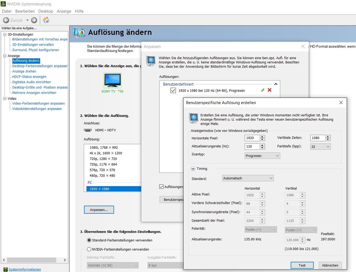

Edit:
OK, in Nvidia control settings I can edit and add custom resolutions:
Tried 100 Hz first, but the TV seem to have some kind of issue with that:

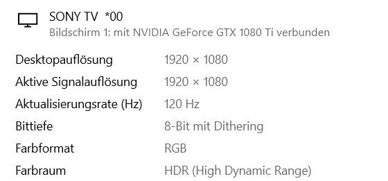

Then I tried 120 Hz and it worked, even with HDR! At 120Hz the Windows desktop feels so much smoother. I am totally amazed. Will never go back to 60 Hz again.
