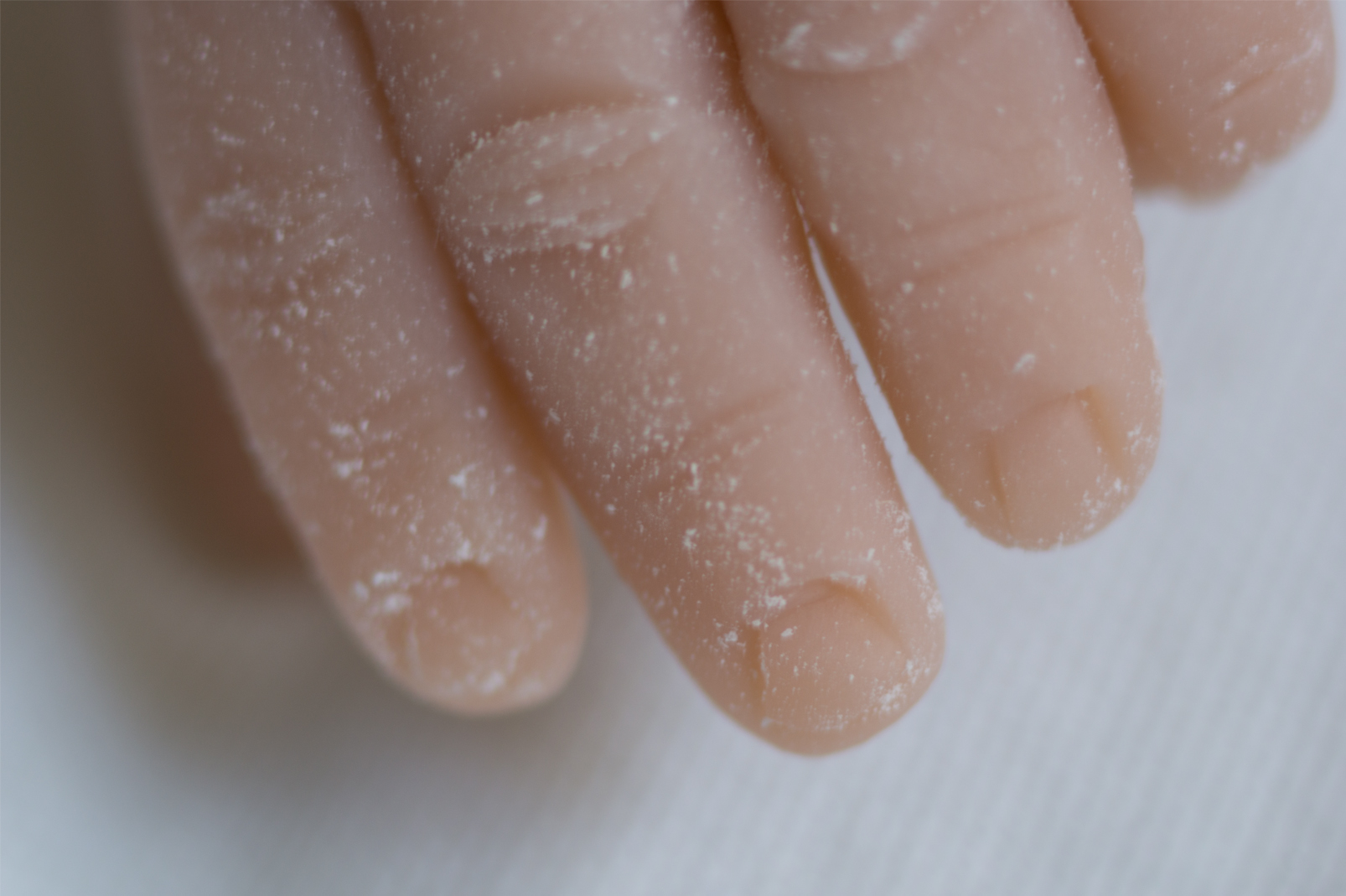

I have tried them with a Sigma lens and was only able to focus manually. AF doesn't work for me yet. Please see my the sample shots I took (photo 1 is a 2cm wide doll's hand with powder from being sanded, photo 2 is a cushion cover).

My own judgement doesn't seem to be good enough because the images are mostly blurry. When I have the apeture at f4.0 only a small area is in focus but the shutter speed is fast, which is good because any tiny movement shows up at this magnification. When the apeture is at f22 - f29 the area of focus is larger but the shutter speed is extremely slow, so the photos are blurry.
